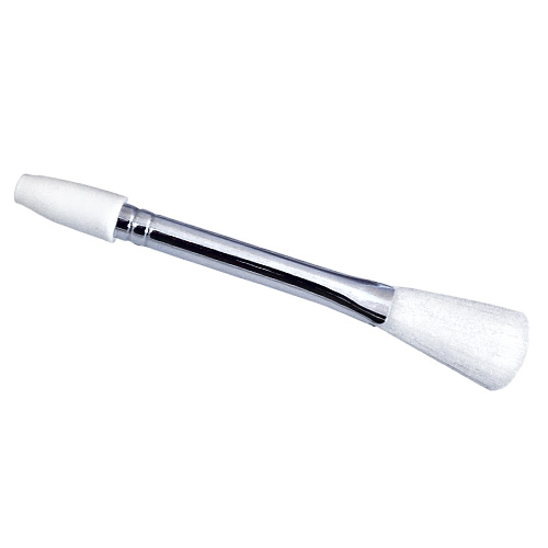

    EVERY TIME I put on my lenses (I store my cameras with lenses removed and always cap all) I will do a Rocket Blower pass with mirror down, then another with mirror up and shutter open. I then take advantage of the sensor being exposed and use a anti-static brush to dust the surface and get off any remaining tiny bits the Rocket Blower leaves behind.
    this is a look at the brush.

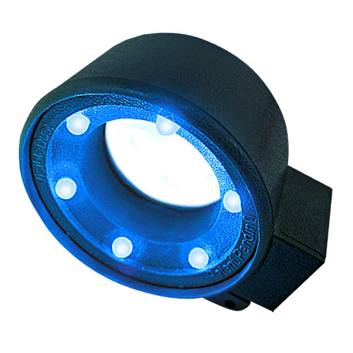

    I use a Sensor Clean Loupe which is very valuable for looking at the surface of the sensor itself. It saves me from having to do lots of tests.
